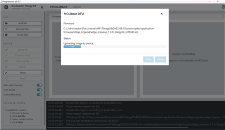

    So I have uploaded the Edge impulse firmware (edge_impulse_1.0.0_thingy53_nrf5340.zip) to the thingy53 as you may see on pictures below :
    The upload looks good, and at the end of it, I can see Application: Thingy53 instead of bootloader.

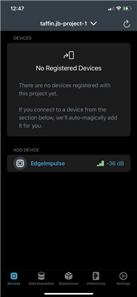

    Then I am looking for a Thingy (or any other name) in Edge Impulse App, but not found :

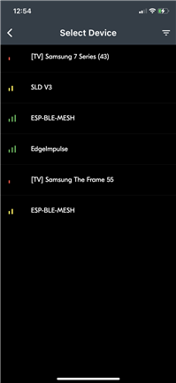

    Also I am looking for thingy in nRF Programmer on iOS, but I cannot see any name.

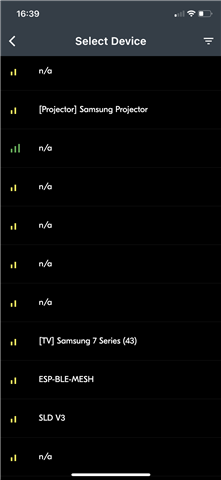

    In addition I tried to update on all nearby devices with n/a names also, but still.

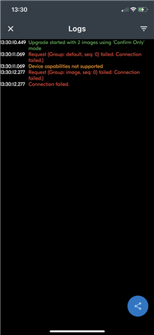

    In addition, any update with nRF programmer on iOS is not working, as seen on 3 screenshots below.

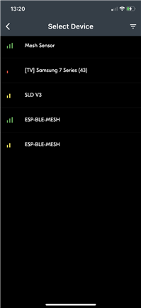

    2) Uploading (with MCU bootloader via USB & nRF programmer windows) matter_weather_station_2.0.2_thingy53_nrf5340.zip
    Upload is successful with nRF programmer windows. Blue led is blinking.
    In addition Thingy53 is visible in nRF Programmer iOS as MatterWeather.

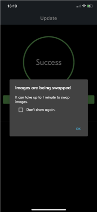

    From there I can update via BLE with iOS nRF programmer (which was not working with EdgeImpulse above..). For instance I update the firmware with BT mesh sensors server (this reason why I bought Thingy53). Device is now seen in app as Mesh Sensor.
    BUT, unfortunately even though the Mesh sensor is recognized i provisionning process in nRF Mesh App, I am unable to connect to the device. Status stays to connecting without connecting.

    I noticed that the only pre-compiled firmware (uploaded with nRF Programmer windows via MCU bootloader) that allow me after to update firmware in iOS nRF Programmer is MatterWeather.
    All the other pre-compiled firmwares, there is an error when trying to update in iOS nRF programmer "Device capabilities not supported".

  • This morning I read about this post ( When do you get the "peer removed pairing information" error? ) about  the "peer removed pairing information".
    I deleted the existing Bluetooth bond between my iPhone and Thingy53 in bluetooth settings, then everything is working back to normal.
    However it looks like the nRF programmer 3.0.8 update on windows was fully necessary for the MCU bootloader to work correctly.
