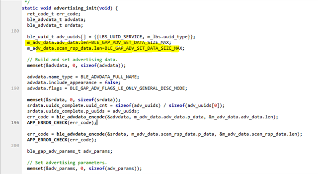

  • Hi Ella,
    I think I found what would be wrong here.
    The advertising_init() was not designed to be used more than once.
    In particular the p_len in ble_advdata_encode() return the length of encoded data. after the call.
    But it's also used as the input for the next call. So if you don't update it to BLE_GAP_ADV_SET_DATA_SIZE_MAX. The next call of advertising_init() will limit the size of the advertising packet down to the size of the last advertising packet. In short m_adv_data is not reinitialized when you call advertising_init() the second time.  This explained the behavior.
    So if you add these:
      m_adv_data.adv_data.len=BLE_GAP_ADV_SET_DATA_SIZE_MAX;
      m_adv_data.scan_rsp_data.len=BLE_GAP_ADV_SET_DATA_SIZE_MAX;
    Into advertising_init(), it should work.
