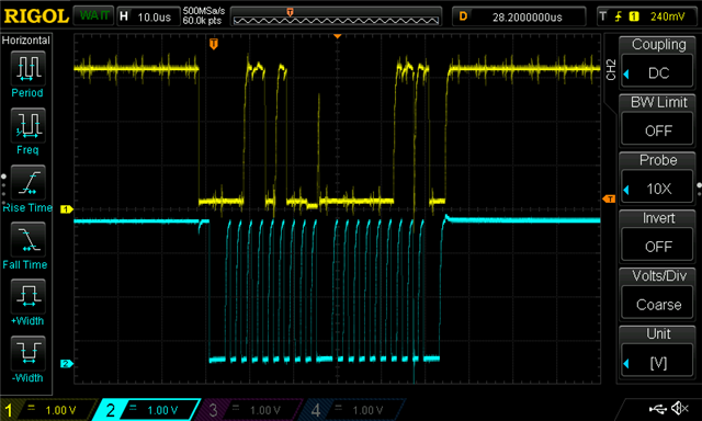

I am currently having some trouble with the I2C communication between my nrf52840dk and the NAU88C22 codec. Although there are times when communication seems to work, it often fails.
To resolve the issue, I have already tried using both the nrf connect sdk and micropython. Interestingly, I have successfully used the same NAU88C22 hardware and micropython software with an ESP32 without any issues.
Currently, I have connected GND, 5V, P0.26, and P0.27 to the NAU88C22 hardware. However, I am not sure if there is anything else that needs to be configured. Additionally, I am wondering if the nrf52840dk pins are 3.3V compatible.
Any help or advice you can offer would be greatly appreciated. Thank you in advance.
