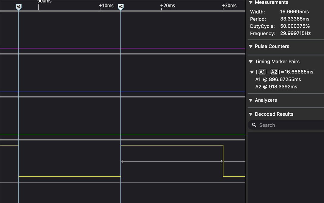

Hello, I've been puzzled with a strange issue that I was hoping to be helped with.
I am noticing differing behavior in the external high frequency clock when flashing with nrfjprog directly compared to using flashing through Segger Ozone.
First off, let me show the difference. I've set up my clock to generate an interrupt every 16,666us. Here is a trace I grabbed with my logic analyzer when I flashed through Ozone.

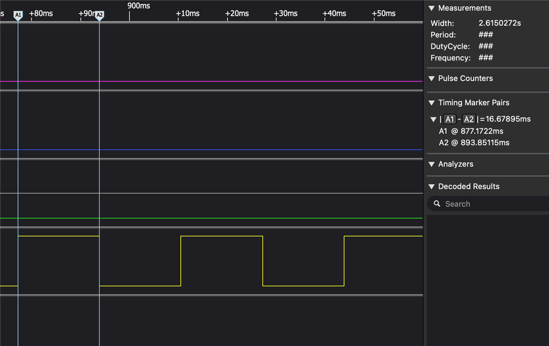

And below is a trace of the same binary, flashed with...
nrfjprog --program nrf52840_xxaa.hex --family NRF52 --sectorerase;
nrfjprog --reset;
You can see that flashing my hardware directly with nrfjprog results in an additional 12us to the clock interval.
Additional detail: The "correct" flashing configuration that Ozone imparts is retained after a hardware reset. However when I run nrfjprog --reset, the issue affecting the clock returns.
