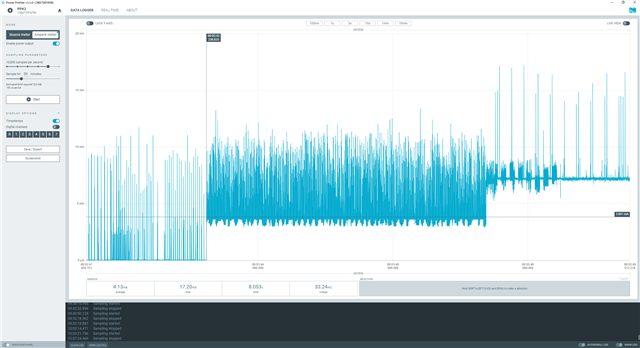

    1. The issue occurred on custom HW, mounting a nRF52832, however I could replicate it on the corresponding DK.

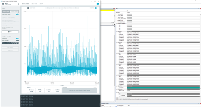

      Attached is the PPK2 log of the same phenomenon replicated on a PCA10040 rev 1.2.4 from 2018.12 batch.
      In this code I had to change the pins for SW and LEDs such that it is compatible with the DK, however the issue is still the same.

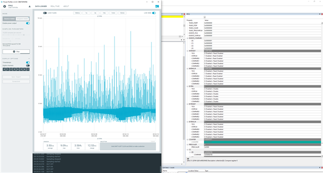

  • Here some more details:
    I managed to log the event with RTT adding the snippet below to the nrf_pwr_mgmt_run function:

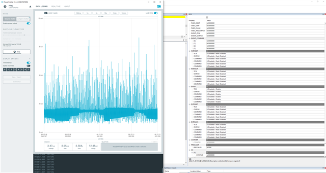

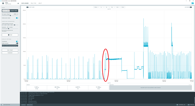

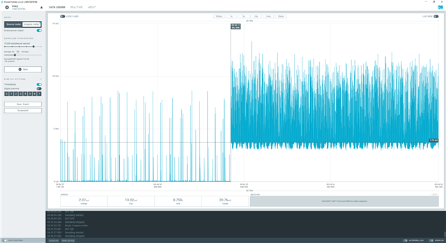

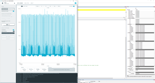

    Attached is the log after the trigger of the event and the PPK2 anomalous consumption.
    As you can see from the log, in this case the trigger is generated by the RTC2 instead of the RADIO, however, the RTC2 is not even initialize in our code.

  • Hi Sigurd,
    tentatively I created a fork project of the one described above using SDK 17 and softdevice sd132 - 7.2.0
    The problem of the anomalous power consumption due to continuous interrupts persists, nothing changed.
    Did you find something?
    The RTC2 timer is used in the bootloader project. So could be that it's somehow still running after your application is booted.
    Suddendly after a FW update OTA via BLE (using a slighly changed version of Secure BLE DFU Bootloader)
    What was slighly changed?
    I noticed that but we did not change the code regarding the RTC2 used by the watchdog and timeout timers. And if the RTC2 was still enabled, it should trigger the interrupt regularly from the restart of the code in the main app. Instead, the time it takes to manifest the anomalous triggers is variable.
    We replaced the "nrf_bootloader.c" with a custom_nrf_bootloader.c, which is almost the same but differs in  the "loop_forever" function where we added a function that changes the advertising name with a runtime built one and manages the switches and leds of the custom board.
    The functions for managing the leds use the apptimer from nordic though. I will try to remove these functions and run the test once again.
