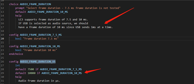

nRF5340 AUDIO ,AUDIO FRAME DURATION
My project base on NCS V2.2.0.BIS mode,gateway
My "AUDIO FRAME DURATION" is 10ms.But my audio source is not i2s or usb.
My audio come from uart,1M bit/s.It will take 2-3ms.
and Lc3 encode take 5-6 ms.then time is not enough.
Can I modify this:AUDIO_FRAME_DURATION_US(I tried ,but failed),or an I reduce LC3 encode time.
any advice will be helpful.

    No, the audio frame duration is highly related with
    • The synchronization and drift compensation mechanism in audio_datapath module
    • The frame size setting for LC3 ENC/DEC
    • I2S sampling number
    And it is very strange that the customer needs 5~6ms for encoding the data.
    There way to reduce the LC3 encoded time is to low down the bitrate.
    But it is still hard to understand what would the customer want to achieve, seems the audio is not from I2S but from UART.
    In addition: The audio frame duration is set by the LE Audio standards. It is not user adjustable. (It is possible to choose other codecs and other frame sizes, but that is a proprietary extension and out side the specs. For a qualifiable solution, the standardized frame size must be supported.)
    Would it be possible for you to share more details of what you are trying to achieve? Our audio team would like to assist, however, more details are needed.

  • 1.Yes,My audio from uart.
    2.LC3 encode need 6ms,I invert IO in "encoder_thread",it takes about 6ms.Then I have no time do my own work,such as another encode.
    3.My codec only suport 44.1K,So I need 44.1K.

  • 1.
    static void encoder_thread(void *arg1, void *arg2, void *arg3)
    	int ret;
    	uint32_t blocks_alloced_num;
    	uint32_t blocks_locked_num;

  • 1. That is not an accurate way to measure the execution time, since the nRF Connect SDK is build on the Zephyr RTOS, and this process runs as a thread - i.e it may be interrupted so long as it fulfills its real-time constraints. The way you are measuring it indicates that it is blocking, but this is not the case - other tasks and threads can run inbetween, depending on their priority.
    You could instead use runtime statistics if you want to know what percent of the CPU is being used by a specific thread, for instance.

  • 1.You are right,I fixed this.Now is not a problem.
    2.I still confuse.Can BIS mode suport 44.1K biterate.My hardware only suport 44.1K biterate,So I need LC3 suprot 44.1K,but seems like LC3 not suport 44.1K in project NRF5340 Audio.
    This is correct - there is unfortunately no support for 44.1 kHz in the nRF5340 Audio reference application as of now.
