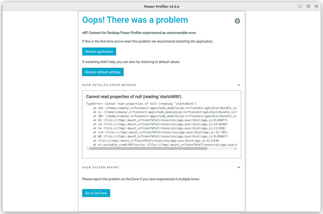

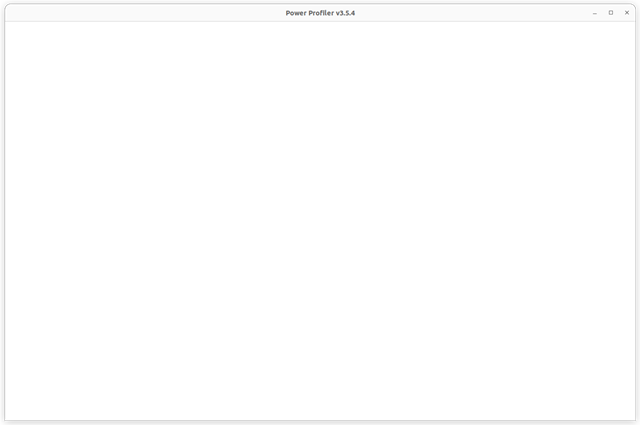

I have just updated my nRF Connect for Desktop to v4.0.1 on ubuntu and Power Profiler kept on v3.5.4. Once I got back to the home screen and click on power profiler I get a few seconds of the normal screen and then a blank window when I have my power profiler kit (ppk2) plugged in.
Then I closed the window and unplug the ppk2 and open it again it shows the normal screen until I plugged that back in and shows the following screen.
It has the following Typescript error and would give the same error if I repeat
Cannot read properties of null (reading 'startsWith')
TypeError: Cannot read properties of null (reading 'startsWith')
    at oUt (/home/cheston/.nrfconnect-apps/node_modules/pc-nrfconnect-ppk/dist/bundle.js:564:4166)
    at Lc (/home/cheston/.nrfconnect-apps/node_modules/pc-nrfconnect-ppk/dist/bundle.js:564:4328)
    at XKt (/home/cheston/.nrfconnect-apps/node_modules/pc-nrfconnect-ppk/dist/bundle.js:565:1553)
    at m2 (file:///tmp/.mount_nrfconrFdTEu/resources/app.asar/dist/app.js:9:49877)
    at v4 (file:///tmp/.mount_nrfconrFdTEu/resources/app.asar/dist/app.js:11:8169)
    at h4 (file:///tmp/.mount_nrfconrFdTEu/resources/app.asar/dist/app.js:11:858)
    at xre (file:///tmp/.mount_nrfconrFdTEu/resources/app.asar/dist/app.js:11:781)
    at NE (file:///tmp/.mount_nrfconrFdTEu/resources/app.asar/dist/app.js:9:85867)
    at file:///tmp/.mount_nrfconrFdTEu/resources/app.asar/dist/app.js:9:37195
    at et.unstable_runWithPriority (file:///tmp/.mount_nrfconrFdTEu/resources/app.asar/dist/app.js:8:34190)
Can I please have the fix for this?

  • I got the same error in Ubuntu 22.04.

    We are looking into this crash and will come up with a fix soon. Meanwhile, I would suggest you to install nrf-udev as it should fix the issue for now.
