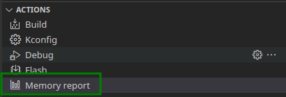

Hello Devzone Support,
is it possible to run the "Memory Report" from the nRF Connect SDK VS Code extension also from the console for continuous integration purposes?

  • Yes:
    Fullscreen
    1
    2
    3
    west build -t rom_report
    west build -t ram_report
    west build -t partition_manager_report
    XXXXXXXXXXXXXXXXXXXXXXXXXXXXXXXXXXXXXXXXXXXXXXXXXX
    or
    Fullscreen
    1
    2
    3
    4
    cd build
    ninja rom_report
    ninja ram_report
    ninja partition_manager_report
    The second option works for child images as well.
