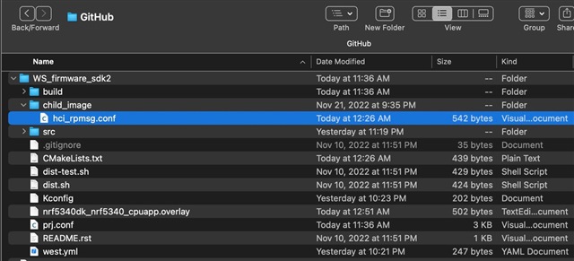

We have a "child_image" folder which contains the file "hci_rpmsg.conf", which looks like this:
CONFIG_LOG=n #changed
CONFIG_SERIAL=n #added
CONFIG_RPMSG_SERVICE=y
CONFIG_RPMSG_SERVICE_MODE_REMOTE=y
# CONFIG_HEAP_MEM_POOL_SIZE=8192
CONFIG_MAIN_STACK_SIZE=2048
# CONFIG_SYSTEM_WORKQUEUE_STACK_SIZE=2048
# CONFIG_BT=y
# CONFIG_BT_HCI_RAW=y
# CONFIG_BT_MAX_CONN=2
# CONFIG_BT_CTLR_ASSERT_HANDLER=y
# CONFIG_BT_HCI_RAW_RESERVE=1
# CONFIG_BT_BUF_CMD_TX_COUNT=8
# Workaround: Unable to allocate command buffer when using K_NO_WAIT since
# Host number of completed commands does not follow normal flow control.
CONFIG_BT_BUF_CMD_TX_COUNT=10

The project folder looks like this:
As per this devzone suggestion: https://devzone.nordicsemi.com/f/nordic-q-a/97081/ncs-v2-3-0-rc1-ota-dfu-does-not-compile, we removed the 5 lines of code recommended there.
I would REALLY appreciate it if you could look at the above and let me know if there are any obvious issues with any of the above.
As I mentioned, the project seems to build OK but after flashing, the code seems to go into an endless "reset loop" (seems to crash immediately after it starts up). Yet the same code seems rot work (with minor changes to add zephyr/ prefix to #include paths) perfectly when built with v1.9.1.
Thanking you in anticipation.
Gerard.
