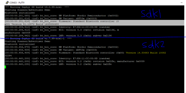

We are having problems migrating our nrf5340 project from SDK v1.9.1 to v2.3.0.
We have now spent more than 1 week on the migration & although the project builds with no (obvious) errors, the code will crash after flashing. So it won;'t run.
With SDK v1.9.1 everything works great and we can't isolate the problem with v2.3.0 & have no way of debugging it as it seems to be in a permanent reset loop after flashing/installing the version built with SDK v2.3.0.
So need your help to figure out how to fix this. Here are some details;
We are using vscode with nrfExtension on MacOS for development and latest nrfConnect version.
We have read the migration guide for v1.x to v2.x and can't see anything there that points to our problem.
We use mcuboot and OTA DFU. It all works well with v1.9.1

    5) You can use sdc_build_revision_get() function from sdc.h to get the build revision. SDC_Build_Rev
    I just ran same sample using different SDKs and here you can see different version of controller with log enable.
    You can read more about SD Controller changes/revisions.
    Softdevice Controller Changelog
