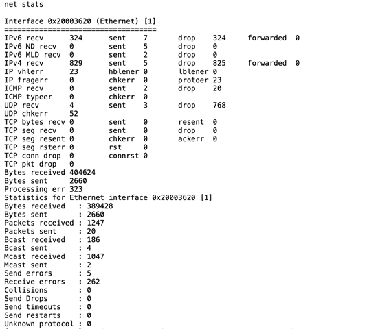

I have  CONFIG_NET_STATISTICS_WIFI and CONFIG_NET_STATISTICS_USER_API set to true and can see interface stats via the shell.
Is there a way to register the Ethernet/WiFi stats so that they will be exposed via the SMP service?

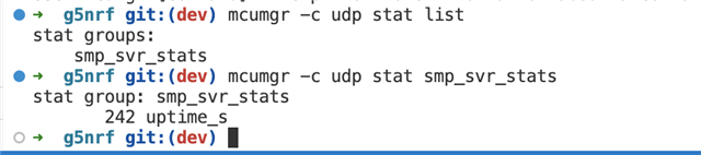

    I am running on a custom board based on the 7002DK and using SDK 2.3.
    The SMP server code is based on the smp sample.
    My app has a shell enabled on the USB port.
    I am using mcumgr in an OS X zsh terminal.
    mcumgr is able to see and retrieve a simple uptime stat I created from the smp server example:
    It's from https://github.com/nrfconnect/sdk-zephyr/blob/fcaa60a99fa9d5256078ed28557856ec3709cfa9/subsys/net/l2/wifi/wifi_shell.c#L379-L423
    Take a look at the Network Statistics API doc and this sample https://github.com/nrfconnect/sdk-zephyr/tree/main/samples/net/stats
