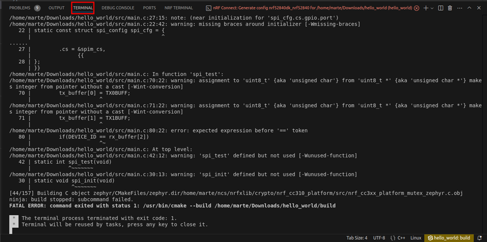

  • Hi all,
    Perhaps I should open a new thread but since my problem is close to this one, I'll tap it in here.
    I tried to use this example in a clean  nRF Connect SDK 2.6.0. project on nRF52840 DK just to try and get simple spi master operation going. However, I'm running into all sorts of build error which don't make sense to me.
    My overlay is:
    &pinctrl {
    	spi1_default: spi1_default {
    		group1 {
    			psels = <NRF_PSEL(SPIM_SCK, 1, 15)>,
    					<NRF_PSEL(SPIM_MOSI, 1, 13)>,
    					<NRF_PSEL(SPIM_MISO, 1, 14)>;
    	spi1_sleep: spi1_sleep {
    		group1 {
    			low-power-enable;
    my_spi_master: &spi1 {
    	compatible = "nordic,nrf-spi";
    	status = "okay";
    	pinctrl-0 = <&spi1_default>;
    	pinctrl-1 = <&spi1_sleep>;
    	cs-gpios = <&gpio0 28 GPIO_ACTIVE_LOW>;
    	reg_my_spi_master: spi-dev-a@0 {
    		reg = <0>;
    &pwm0 {
    	status = "disabled";
    main.c is:
    #include <zephyr/kernel.h>
    #include <zephyr/device.h>
    #include <zephyr/devicetree.h>
    #include <zephyr/drivers/spi.h>
    #define MY_SPI_MASTER DT_NODELABEL(my_spi_master)
    #define DEVICE_ID
    uint8_t TX0BUFF[3];
    uint8_t TX1BUFF[3];
    // SPI master functionality
    const struct device *spi_dev;
    struct spi_cs_control spim_cs = {
    	.gpio = SPI_CS_GPIOS_DT_SPEC_GET(DT_NODELABEL(reg_my_spi_master)),
    	.delay = 0,
    static const struct spi_config spi_cfg = {
    	.operation = SPI_WORD_SET(8) | SPI_TRANSFER_MSB |
    				 SPI_MODE_CPOL | SPI_MODE_CPHA,
    	.frequency = 1600000,
    	.slave = 0,
    	.cs = &spim_cs,
    static void spi_init(void)
    	spi_dev = DEVICE_DT_GET(MY_SPI_MASTER);
    	if(!device_is_ready(spi_dev)) {
    		printk("SPI master device not ready!\n");
    	if(!device_is_ready(spim_cs.gpio.port)){
    		printk("SPI master chip select device not ready!\n");
    static int spi_test(void)
    	static uint8_t tx_buffer[3];
    	static uint8_t rx_buffer[3];
    	const struct spi_buf tx_buf = {
    		.buf = tx_buffer,
    		.len = sizeof(tx_buffer)
    	const struct spi_buf_set tx = {
    		.buffers = &tx_buf,
    		.count = 1

  • Hi Peks1,
    First of all, I recommend looking at the build log in the terminal tab instead of the errors in the problems tab, as this gives you a better overview of the errors. Additionally, the errors from the problems tab might sometimes come from Intellisense and does not necessarily represent the build errors.
    When building your code, I get the following build log:

    [31/157] Building C object CMakeFiles/app.dir/src/main.c.obj
    FAILED: CMakeFiles/app.dir/src/main.c.obj
    ccache /home/marte/zephyr-sdk-0.16.5/arm-zephyr-eabi/bin/arm-zephyr-eabi-gcc -DKERNEL -DNRF52840_XXAA -DPICOLIBC_LONG_LONG_PRINTF_SCANF -D_FORTIFY_SOURCE=1 -D_POSIX_C_SOURCE=200809 -D__LINUX_ERRNO_EXTENSIONS__ -D__PROGRAM_START -D__ZEPHYR__=1 -I/home/marte/ncs/zephyr/include -I/home/marte/Downloads/hello_world/build/zephyr/include/generated -I/home/marte/ncs/zephyr/soc/arm/nordic_nrf/nrf52 -I/home/marte/ncs/zephyr/soc/common/nordic_nrf/. -I/home/marte/ncs/zephyr/soc/arm/nordic_nrf/common/. -I/home/marte/ncs/nrf/include -I/home/marte/ncs/nrf/tests/include -I/home/marte/ncs/modules/hal/cmsis/CMSIS/Core/Include -I/home/marte/ncs/zephyr/modules/cmsis/. -I/home/marte/ncs/modules/hal/nordic/nrfx -I/home/marte/ncs/modules/hal/nordic/nrfx/drivers/include -I/home/marte/ncs/modules/hal/nordic/nrfx/mdk -I/home/marte/ncs/zephyr/modules/hal_nordic/nrfx/. -I/home/marte/ncs/modules/debug/segger/SEGGER -I/home/marte/ncs/modules/debug/segger/Config -isystem /home/marte/ncs/zephyr/lib/libc/common/include -isystem /home/marte/ncs/nrfxlib/crypto/nrf_cc310_platform/include -fno-strict-aliasing -Os -imacros /home/marte/Downloads/hello_world/build/zephyr/include/generated/autoconf.h -fno-printf-return-value -fno-common -g -gdwarf-4 -fdiagnostics-color=always -mcpu=cortex-m4 -mthumb -mabi=aapcs -mfp16-format=ieee -mtp=soft --sysroot=/home/marte/zephyr-sdk-0.16.5/arm-zephyr-eabi/arm-zephyr-eabi -imacros /home/marte/ncs/zephyr/include/zephyr/toolchain/zephyr_stdint.h -Wall -Wformat -Wformat-security -Wno-format-zero-length -Wno-pointer-sign -Wpointer-arith -Wexpansion-to-defined -Wno-unused-but-set-variable -Werror=implicit-int -fno-pic -fno-pie -fno-asynchronous-unwind-tables -ftls-model=local-exec -fno-reorder-functions --param=min-pagesize=0 -fno-defer-pop -fmacro-prefix-map=/home/marte/Downloads/hello_world=CMAKE_SOURCE_DIR -fmacro-prefix-map=/home/marte/ncs/zephyr=ZEPHYR_BASE -fmacro-prefix-map=/home/marte/ncs=WEST_TOPDIR -ffunction-sections -fdata-sections --specs=picolibc.specs -std=c99 -MD -MT CMakeFiles/app.dir/src/main.c.obj -MF CMakeFiles/app.dir/src/main.c.obj.d -o CMakeFiles/app.dir/src/main.c.obj -c /home/marte/Downloads/hello_world/src/main.c
    /home/marte/Downloads/hello_world/src/main.c:27:15: warning: initialization of 'const struct device *' from incompatible pointer type 'struct spi_cs_control *' [-Wincompatible-pointer-types]
       27 |         .cs = &spim_cs,
    /home/marte/Downloads/hello_world/src/main.c:27:15: note: (near initialization for 'spi_cfg.cs.gpio.port')
    /home/marte/Downloads/hello_world/src/main.c:22:42: warning: missing braces around initializer [-Wmissing-braces]
       22 | static const struct spi_config spi_cfg = {
       28 | };
    /home/marte/Downloads/hello_world/src/main.c: In function 'spi_test':
    /home/marte/Downloads/hello_world/src/main.c:70:22: warning: assignment to 'uint8_t' {aka 'unsigned char'} from 'uint8_t *' {aka 'unsigned char *'} makes integer from pointer without a cast [-Wint-conversion]
       70 |         tx_buffer[0] = TX0BUFF;
    /home/marte/Downloads/hello_world/src/main.c:71:22: warning: assignment to 'uint8_t' {aka 'unsigned char'} from 'uint8_t *' {aka 'unsigned char *'} makes integer from pointer without a cast [-Wint-conversion]
       71 |         tx_buffer[1] = TX1BUFF;
    /home/marte/Downloads/hello_world/src/main.c:80:22: error: expected expression before '==' token
       80 |         if(DEVICE_ID == rx_buffer[2])
    /home/marte/Downloads/hello_world/src/main.c: At top level:
    /home/marte/Downloads/hello_world/src/main.c:42:12: warning: 'spi_test' defined but not used [-Wunused-function]
       42 | static int spi_test(void)
    /home/marte/Downloads/hello_world/src/main.c:30:13: warning: 'spi_init' defined but not used [-Wunused-function]
       30 | static void spi_init(void)
    [44/157] Building C object zephyr/CMakeFiles/zephyr.dir/home/marte/ncs/nrfxlib/crypto/nrf_cc310_platform/src/nrf_cc3xx_platform_mutex_zephyr.c.obj
    FATAL ERROR: command exited with status 1: /usr/bin/cmake --build /home/marte/Downloads/hello_world/build
    The trick to build logs is to start from the top and find the first error, which in this case is the following:
    This error stems from DEVICE_ID not being defined to anything, so the line of code above is basically the same as if( == rx_buffer[2]).
    Your project also gives some build warnings. The build will still finish with these, but they might affect behavior, so you should still look through them.
    Our nRF Connect SDK Intermediate course on DevAcademy has a lesson on SPI, which I recommend going through that. You can find the lesson here: nRF Connect SDK Intermediate Lesson 5 – Serial Peripheral Interface (SPI).
    Marte
  • Hi Marte,
    That's a good pointer to look at the terminal. Thanks!
    There were one or two other small problems which I sorted and it then compiled.
