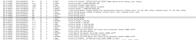

I've noticed on the nRF Connect phone app that there is a bond button. If I'm in just works pairing no bonding mode (settings below), and click the bond button a bond still appears to be done. However, when sniffing the packets I know that the phone acknowledges my security parameters, where I say bonding is not allowed. However it seems like a bond still happens on the phone, but not on the nRF chip. I assume the nRF does not save any keys, which is why when trying to connect again I have to re-pair. I would guess it's the phone's operating system (Android/IOS) that is still trying to make a bond.

    No I have verified the behavior with a sniffer. You can see the trace here:
    The peripheral clearly say no bonding. And then after the connection is encrypted, no key distributing happen (no LTK). The phone should have forget the device after the connection is terminated as there is no LTK.

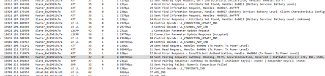

  • Yes, that trace looks similar to mine. Does your device (phone) still keep the bond information? As in going into your Bluetooth settings, does it say the device is bonded?
  • Yes, correct. But of course if you try to read a characteristic that require authentication and get rejected it will send a Pairing Request instead of Encryption Request, showing that it doesn't have any key stored. Thiis is what I get when I connect again to a "bonded" device and try to read encrypt required characteristic:
