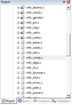

Undefined symbol nrfx_saadc_buffer_convert (referred from main.o).
I am trying to write a code to record an analog signal using the example code in 'examples/ble_peripheral/ble_app_hrs'.
I used 'nrfx_saadc' and 'nrfx_timer' in the code, and there is no problem with 'nrfx_timer'.
However, I encountered an error related to 'nrfx_saadc'. I have activated it by defining '#define NRFX_SAADC_ENABLED 1' from the 'sdk_config.h'
and also added the corresponding header file to the project,
but the error still persists.

  • Thank you for the swift response.
    actually I encountered other errors right now.
    is there something that I have to do further besides changing the drive?
    ..\..\..\main.c(97): error: #20: identifier "nrfx_SAADC_DEFAULT_CHANNEL_CONFIG_SE" is undefined
    static nrf_saadc_channel_config_t m_channel_config1 = nrfx_SAADC_DEFAULT_CHANNEL_CONFIG_SE(ADC_PIN1);
    ..\..\..\main.c(97): error: #59: function call is not allowed in a constant expression
