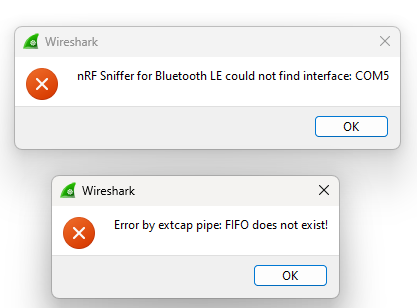

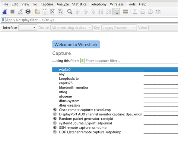

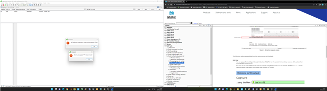

    I've followed the guide to install the sniffer tracer in both the computer and the nRF52. Nevertheless, I can't see the interface in Wireshark:
    In View --> Interface Toolbars I have the 'nRF Sniffer for BlueTooth LE' option enabled but the nRF52DK doesn't seem to be detected even if I was able to flash it with the programming tool. Is there any step I'm missing?

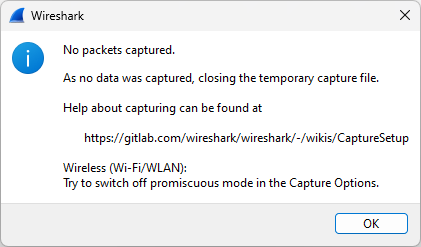

  • Thanks. This shows that the DK is programmed correctly and that the communication works.
    Please check the WS log files for errors as suggested in the Troubleshooting chapter.
