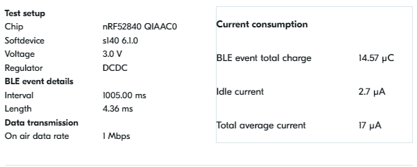

    What is your requierment for average current consumption? You can use the online power profiler to see estimates on what it can be so that you will see what you can realistically achieve (this does not have the nRF52833, but you can select nRF52840 to get comparable numbers).

    Tx power is important (particularily if you use a high Tx power), and the advertising interval. You can experiment with the effect of this using the online power profiler.

    1. my requirement of project to use 3v/3.3v button cell with nrf52833 soc. to advertise for 1 second and goes to sleep for 3 second periodically. minimum total average current should be in range 3uA - 20uA.

    3. in online power profiler, it shows total average current. how many samples of measurement does it take to conclude its total average current.
    Do you mean to send several advertising pckets during this one second, and then no for the next 3 seconds, and then some for 1 second again, etc? If so, you can still use the online power profiler to estimate the current consumption but you need to do some simple calculations your self in addition to take into account that you are only actively advertising for 25% of the time, and for the rest of the you have the idle current consumption.
    This doe snot sample anything, but it is based on models that we have feed a lot of measurement data into. You can see in the plot which current consumption levels calculate for which duration of time with the given configuration.
