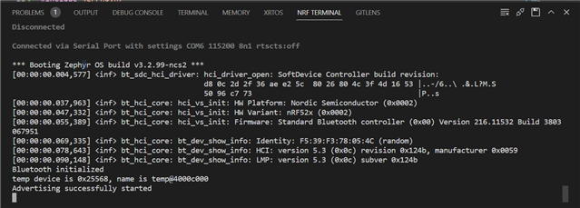

    Thanks for getting back to me.
    I changed the main code (I can send it if needed) and this is what I have right now, the code builds and flashes and I get this message in the nrf terminal, I try opening the nrf connect for desktop ble it is not working, is there an alternative?
    I downloaded the nrf connect for mobile as my peripheral and I can connect but where can I read the temperature values?

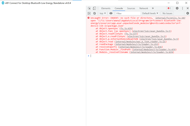

    can you try the following :
    uninstall the Bluetooth Low Energy from the OS 'Add and Remove Programs' and try to reinstall is and see if this resolves the issue?
    • make sure that the client rebooted the machine before reinstalling
    • If the above does not solve it can you try to manually install jLink 7.66a manually after 4.0.0 is installed
    Can you upload the code with using insert --> code?
    If you place a breakpoint on the  line "ret = sensor_channel_get(temp_dev, SENSOR_CHAN_DIE_TEMP, &val);" do you get any values in the "ret" variable?

    I tried a different computer the application works now thanks but the device does not connect it displays an error message that access to the COM is denied,

  • Hi and thanks for the code
    Next time, can you upload it using insert --> code? It makes it more readable then a normal copy/paste
    I can't see that you are publishing your temperature data anywhere over BLE, only over UART with prink
    I would recommend looking into exercise 2 in our Bluetooh Low Energy Fundamentals course . The exercise covers publishing a button press counter, this can easily be adapted to reading a temperature. In general I would recommend the course if you are new to BLE or our course covering NCS if you are new to nRF Connect SDK
    Regards
    Runar
    I followed the BLE course and I am now getting temperature values:
