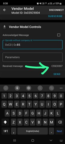

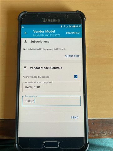

thank you for your reply, i've referred that and as well completed the two courses earlie i have been able to activate vendor model control referring this https://developer.nordicsemi.com/nRF_Connect_SDK/doc/latest/nrf/protocols/bt_mesh/vendor_model/dev_overview.html. But i can't pass opcodes as well as receive acknowlegment i'm stuck with it. Also my requirement is i should enable vendor model controls and when i pass a specific opcode for eg: 0x85 i should receive a specific acknowlegement to the nrf mesh app and onboard led1 should be instantiated. I am attacking two photos one showing i have been able to activate vendor model and the other showing what is expected. i am also attaching my zip file can you please point me in the right direction and tell me what changes is required to be done
