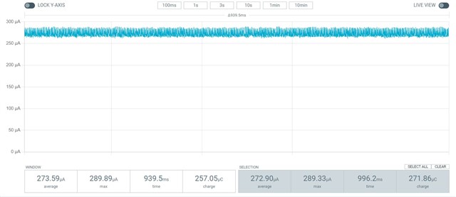

I am new to working in BLE. I am using nRF5340DF kit. I have generated a sample project and have added configurations in prj.conf as shown below
CONFIG_CONSOLE=n
CONFIG_UART_CONSOLE=n
CONFIG_BT=y
My main function code is
void main(void)
    int err = 0;
    err = bt_enable(NULL);
    for (;;)
      k_sleep(K_MSEC(1000));
But when measuring power using PPK 2, i am able to see that BLE is using 273uA in idle state and if I am not using "CONFIG_BT=y" in the configuration file then the current used is only 6uA.
I am using k_sleep() to put the board in IDLE state. In my project I cannot put the board in "System OFF state".  Can any one please guide me how to reduce the idle power consumed in BLE ?
