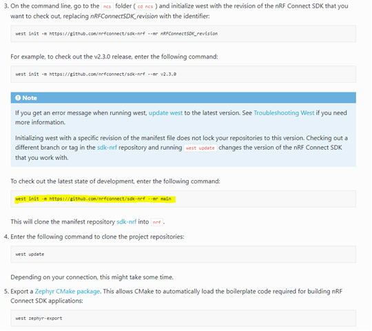

    The PR is merged. You can the latest state of development. See Get the nRF Connect SDK code to install the main version. Then, set the SDK to main version in the VS Code.
    -Amanda H.
  • Hi, I am using the SDK 3.0.0 and in this SDK version I go the error mesage "TF-M non-secure address start is not aligned on SPU region size" as posted in the first message. Do I need to downgrade my SDK or use the 2.2.9?
    I think it's a typo. The latest version currently is v2.3.0. The bug exists in v2.3.0.
    To install the latest development version, you have to install it manually.
    After installing the main version, your directory structure now looks similar to this:

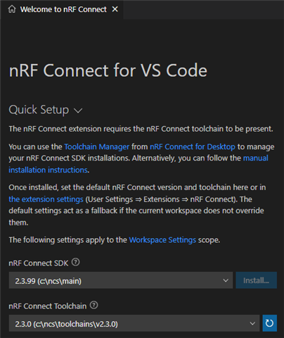

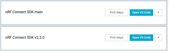

    The toolchain manager would look like this
    -Amanda H.
    I followed the instructions on this website: developer.nordicsemi.com/.../installing.html which is basically the same as the one you showed in your snippet images. It does install the SDK, but I didn't know how to install the toolchain. I then uninstalled it and reinstalled it using the toolchain manager and it worked.
    At the moment I have a compiled version that I can test and look at a bit.
    Thanks a lot for the help and wish you a nice day
