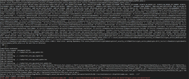

Hello everyone !
I am following the tutorial "Reading Thingy:53 sensor data using Bluetooth LE".
It doesn't matter if I don't do it myself or if I take the source program from github the project doesn't build.
I have the following error:
FATAL ERROR: command exited with status 1: 'c:\ncs\toolchains\v2.3.0\opt\bincmake.EXE' --build 'c:\Users\fduvi\Desktop\stage\Nordic_LTEthingy53_sensor_hub-masterthingy53_sensor_hub-master'
Can someone help me ?
Pierre
Here we can see the error with the source program
  • Hello !
    I put the paths of each library that the compiler could not find which allowed me to move on to the rest of the compilation!
    Now I have the following problem:

  • Could you upload your project for me?
    Regards
    Runar
    Sorry for my late answer.
    I tried with the NCS v2.2.0 and it didn't work either...
    Regards
    Pierre
  • Hi, sorry for the delay.
    I'm working on getting a ported example of the project for ncs 2.4
    Regards
    Runar
    I just tried the new example and it works !
    Thank you very much !
    Regards
    Pierre
