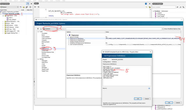

  • With a custom board you will need to modify the board files. You can find the board files under:
    \SDK_INSTALL_FOLDER\components\boards
    When creating a new board file, simply copy the pca10056.h file, rename it, and modify it after your requirements. Then you have to modify boards.h to support your new file, and add a new preprocessor define that you can specify in the makefile/ SES project to include your modified file.
    In SES, here is how you set the board to be used by the SES project.
