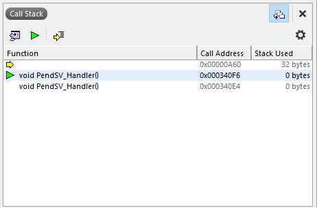

    Right now my crash is happening like this... in xPortSVHandler
    Earlier I have seen the Call stack show a series of Add Queue, Queue_Process calls before crashing.
    I have tried greatly increasing the FreeRTOS heap size and the task stack size during xTaskCreate()
    configMINIMAL_STACK_SIZE=360,  configTOTAL_HEAP_SIZE=32768
    None of that has helped.

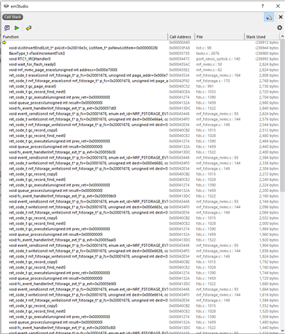

  • Here is capture of a crash when running fds_gc().  In this case I am not using the softdevice.  I have set FDS_BACKEND=1.
    This all started with a single call to fds_gc()
    Sorry a large screen capture and thats only half the list.  SES does not seem to have a way to copy the contents.
    I have seen this exact hard fault many times - dies at vListInsertEnd().
    gc_execute seems to run recursively until it runs out of stack ?
  • Yes, it looks like it runs recursively until it runs out of stack.
    How/where do you call fds_gc() in the application?
    I see that you are using FreeRTOS. Have you tried to reproduce this behavior in a project without FreeRTOS?
    Can you provide a minimal project to reproduce the behavior?
