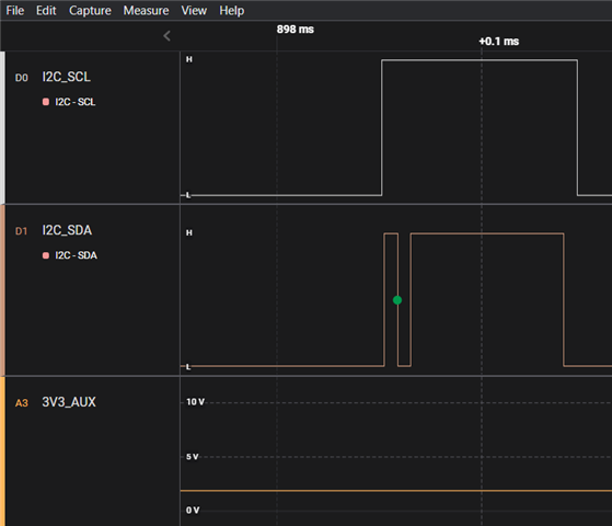

  • Hi
    I do have both CONFIG_PM_DEVICE and CONFIG_PM_DEVICE_RUNTIME enabled.
    When I use the twi driver (not twim), my I2C calls work as expected. See the image below.
    When I use the twim driver (not twi), the I2C calls never seem to work. See the image for an I2C read.
    The twim driver behaves the same with CONFIG_PM_DEVICE and CONFIG_PM_DEVICE_RUNTIME both enabled and both disabled.
    I would like to use the twim driver because it has built in support for PM, whereas the twi driver does not.
    What could I be doing wrong that prevents the twim driver from reading / writing as expected? I only have one peripheral on the I2C bus, and the HW is validated as shown with the twi driver.
    Rob
