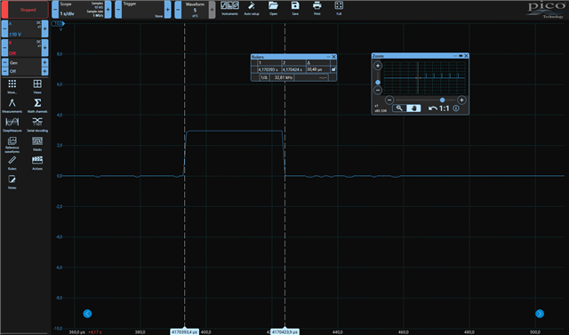

Until now I haven't managed to observe the PWM signal on the scope. I am only getting a single pulse and the LED stays off.

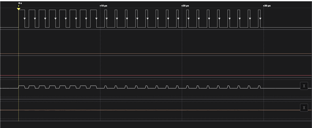

    Testing your code, it seems to work for me:
    However, I don't have an LED attached to pin 23.
    Do you see the same if you use a GPIO that isn't connected to anything? It could be that it is too fast for the nRF to be able to toggle the gpio connected to an LED, at least without enabling high drive.

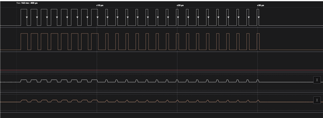

    FYI, I tried to use both a GPI connected to an LED and one not connected to anything:
    The Channel 0 (white) is not connected to anything, while channel 1 (brown) is pin 17 on the DK, connected to LED1. You can see that it was able to drive both, but from the analog view on the bottom, you can see that it is struggling a bit more with channel 1, so it may depend on the LED that you are using.
    BR,
    Edvin

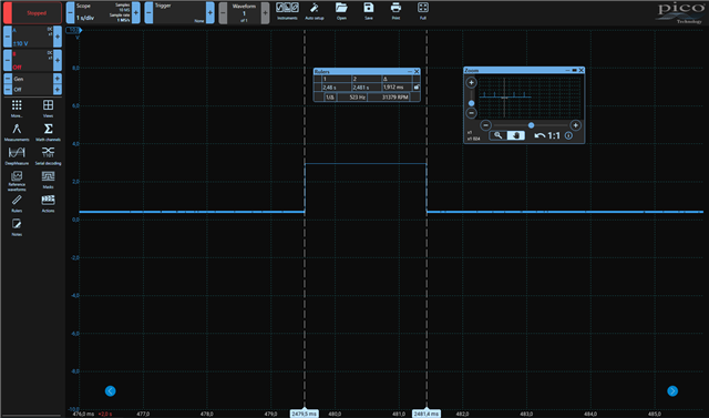

    Thank you for the reply.
    It's good to see that it is working on your DK.
    I've tried the following:
    - Changing clk to 125kHz
    - Configuring the pins with high drive mode
    on the following:
    - a Free GPIO pin (pin 20)
    - A GPIO Pin connected to the RGB LED (pin 23)
    - A GPIO pin connected to a simple LED indicator (pin 19)
    on both my custom board and a DK (PCA10040 V3.0.0).
    I always have the same results on all the pins:
    - A single pulse with about 1920µs duration when clk = 125 kHz
    - A single pulse with about 30us duration when clk = 8 MHz
    NRF52832_PWM_CLK_8Mhz_pin23_DK_PCA10040_3.0.0
    NRF52832_PWM_CLK_125k_pin23_DK_PCA10040_3.0.0
    We expect a signal with 24 periods @1.25us each for clk = 8Mhz or @8µs each for clk = 125khz:
    1.25*24 = 30µs
    8*24 = 1920 µs
    So the pulses duration are pretty consistent with the expected waveform duration.
    Since the behavior seems to be the same on the DK and the custom board for me,
    the issue might be related to the scope. Or can we rule out the NRF SDK configuration ?
    I'm using a picoscope 2204A With 10 MHz bandwidth: www.picotech.com/.../picoscope-2000-specifications
    with a minimum detectable pulse width of 5 ns. The expected signal has a minimum width of 300 ns.
    So the scope should be able to display the waveform. Anyway I'm going to try with a more advanced one.
