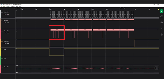

In this project, RTC1 triggers every 500us, while SPIM3 continuously sends the following data set: command 0x2b, data 0xfA, 0xfC, 0xfD, 0xfE, 0xf8.
During testing, we observed that when the data ends with 0xf8 or 0xf9 (although it is uncertain if only these two values are affected, but 0xf8 and 0xf9 have a high probability), the data sent by SPIM seems to be easily interrupted by RTC interrupts, despite there being no apparent relationship between them. When capturing the data with a logic analyzer, we always found the sending data is incorrect.

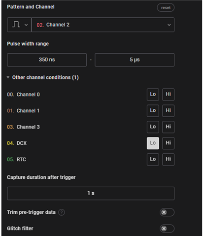

inside the logical analyzer we set the filter as below:
As shown in the diagram, channel 2 represents the MOSI pin. The reason for setting the pulse duration from 350us to 5us is that under normal circumstances, the pulse width of the first byte (0x2b) sent by SPIM is less than 350us, and it is triggered by a low level on DCX. If this condition is not met, it indicates that the first byte is not 0x2b, which is inconsistent with our program settings, and indicates a data transmission error.

in our prject we expect the data & cmd should be send as below(the first byte for cmd is 0x2b):

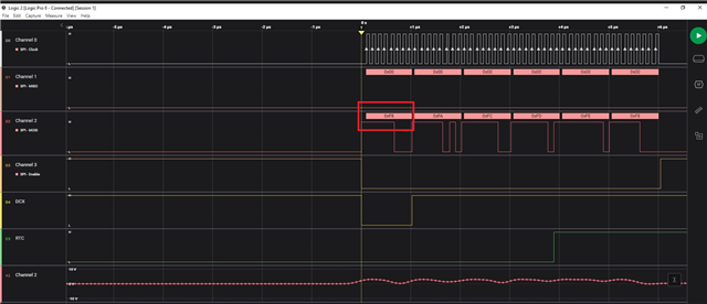

The error data could show as below:(the first byte has been change to 0xF8 ):

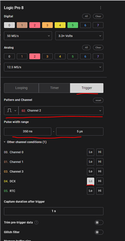

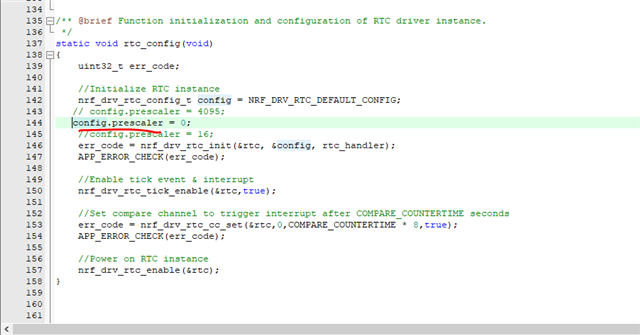

  • Yes this issue could be reproduce on 52840 DK. if you change the  config.prescaler = 0, this issue could be easy to reproduce,since the RTC interrupt became to 30.5us.
    It should be noted that due to the large amount of data captured by the logic analyzer, it is necessary to set the trigger mode for the logic analyzer, otherwise it may be difficult to see erroneous data. The trigger mode is set as follows:

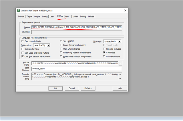

  • That is most likely Errata 198 from the errata sheet. SPIM3 TX can be easily corrupted unless you explicitly use a reseved RAM block.
    Kind of a nightmare setting up the the ld script.
    Try using any other SPI peripherial.
  • Thanks !! your right ,after i add NRFX_SPIM3_NRF52840_ANOMALY_198_WORKAROUND_ENABLED, this is issue has been fixup
