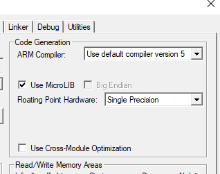

    Also please let us know which Keil compiler was used (Compiler v6 or compiler v5)
  • Ok, tried an example from SDK 17.1. Only changed the nRF_DeviceFamilyPack from Keil's pack manager. Got the same result.
