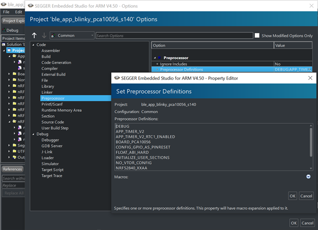

    As general advice (not applicable to the return code from the diskio.h functions, but to other SDK functions): since you are working with the nRF5 SDK you should also pass your error codes to an APP_ERROR_CHECK() and make sure to have DEBUG defined in your preprocessor defines like so:
    This will make your logger output a detailed error message whenever a non-NRF_SUCCESS error code is passed to an APP_ERROR_CHECK.

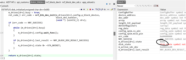

     Which line of disk_initialize do you get to before it returns to main, when you set breakpoints to check?
    Here what happens inside the disk_initialize function.
    Three initialization attempt are done:
    for (uint32_t retries = 3; retries && disk_state; --retries)
    disk_state = disk_initialize(0);
    if (disk_state)
    What happens inside is that it behaves differently in the first attempt with respect to second and third.
    In all the three attempt, the last message you get to before going back to main is:
     return m_drives[drv].state
    and its value is always 1. This is located in the diskio_blkdev.c file (see below image)

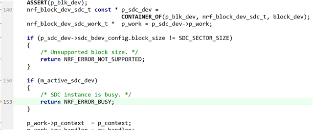

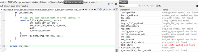

    However, looking more in deep in the  block_dev_sdc_init function in the nrf_block_dev_sdc.c file, the results are different between the first attempt and the other two.
    In the first attempt, everything seems to go fine, neither the Unsupported block size and the SPI busy errors appear, the spi_init does not return error and the final err_code is 0:
    In the other two attempts, the NRF_ERROR_BUSY error is returned instead
