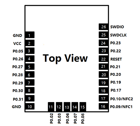

I'm trying to use the SKB501 Module from Skylab, containing a nRF52840.
Programming and Erasing the Chip with an Elpotronic Programmer works fine.
But Programming and Erasing just works once with a CMSIS-DAP Programmer. I tried a CMSIS-DAP from AliExpress (https://aliexpress.com/item/1005003843743542.html) and also the picoprobe firmware for RP2040, which also provides a CMSIS-DAP interface.
After erasing the flash with the Elpotronic Programmer, I can program the module one time with pyOCD together with one of the CMSIS-DAP Programmers. After this one time programming process, I can't reprogram or erase the device. I get the following error:

Any idea how to fix this? Is the nRF52840 not compatible with CMSIS-DAP Programmers?
The Pinout of the SKB501 Module is as following. GND is connected to GND, VCC is connected to 3.3V. SWDIO/SWDCLK is connected to the programmer. RESET is connected with 10k to VCC. Do I need to connect more pins, or can I leave the remaining pins floating?

  • Ok, I think my direction with that the module was locked is wrong.
    The real issue was that this module doesn't have a 32k Crystal. Thus, running FW which relies on this crystal will put it into a kind of locked state.
    The elpotronic programmer was still able to program it reliable as it also controls the power supply and thus was able to program it before the module tried to switch to the 32k crystal.
    Adding these configs to prj.conf helped:
    CONFIG_CLOCK_CONTROL_NRF_K32SRC_XTAL=n
    CONFIG_CLOCK_CONTROL_NRF_K32SRC_RC_CALIBRATION=y
    CONFIG_CLOCK_CONTROL_NRF_K32SRC_500PPM=y
