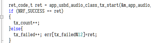

i add function to USB audio demo as follow:

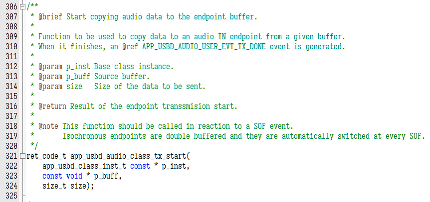

uint16_t usb_put_data(const uint16_t* p_buff, uint16_t size)
 	ret_code_t ret = app_usbd_audio_class_tx_start(&m_app_audio_microphone.base, p_buff, size*2);
 	if (NRF_SUCCESS == ret)
		//bsp_board_led_invert(LED_AUDIO_RX);
	return size;
don't know if it sucess, so some audio data lost.
it note This function should be called in reaction to a SOF event.
where the SOF?

    I assume you have taken a look at how it's done in the usbd_audio example.
    In the usbd_user_ev_handler, you get the event APP_USBD_EVT_DRV_SOF. Here app_usbd_audio_class_rx_start() is called, and when that is completed, you get the APP_USBD_AUDIO_USER_EVT_RX_DONE in hp_audio_user_ev_handler(), and here app_usbd_audio_class_tx_start() is called. In that way, it's called in a reaction to a SOF event, in the usbd_audio example.

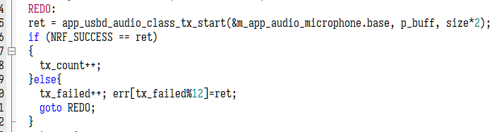

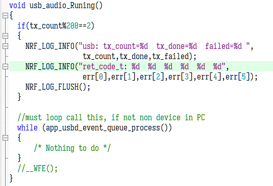

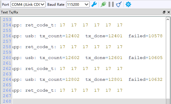

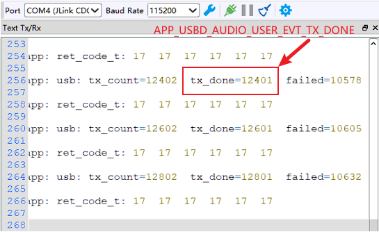

    1.Using app_usbd_audio_class_tx_start() directly,  i suspect losing some data frames.
    2.put data to a memery buffer first, then where to call app_usbd_audio_class_tx_start()?
    if call it once in first put to buffer,and then call in APP_USBD_AUDIO_USER_EVT_TX_DONE,
    will lost most of audio data.
    Best regards

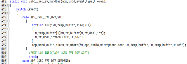

    Try calling it in the usbd_user_ev_handler() when you get the event APP_USBD_EVT_DRV_SOF . Also remember to check the return code from app_usbd_audio_class_tx_start() if you are suspecting you are losing data.
  • Hi,  thanks for reply
    i'v try,but it never to be called.  see code

    static void hp_audio_user_ev_handler(app_usbd_class_inst_t const * p_inst,app_usbd_audio_user_event_t   event)
        app_usbd_audio_t const * p_audio = app_usbd_audio_class_get(p_inst);
        UNUSED_VARIABLE(p_audio);
        switch (event)
            case APP_USBD_AUDIO_USER_EVT_CLASS_REQ:
                hp_audio_user_class_req(p_inst);
    				case APP_USBD_AUDIO_USER_EVT_RX_DONE:
                /* Block from headphones copied into buffer, send it into microphone input */
                if(nLoop){
    							ret_code_t ret = app_usbd_audio_class_tx_start(&m_app_audio_microphone.base, m_temp_buffer, m_temp_buffer_size);
    							//if (NRF_SUCCESS == ret) bsp_board_led_invert(LED_AUDIO_RX);
    						}else{
    							uint16_t c = put_data(m_temp_buffer, m_temp_buffer_size);//I2S
    	Call this in I2S check_rx_data(),16bit 48Khz STEREO, size=80
    	for(int i=0;i<size;i++)
    		m_tx_buffer[m_tx_start_idx]=p_buff[i];
    		m_tx_start_idx%=BUFFER_TX_SIZE;
    	m_temp_buffer_size=size; havedata+=size;
    	//if(tx_done)return size;
    //	ret_code_t ret = app_usbd_audio_class_tx_start(&m_app_audio_microphone.base, p_buff, size*2);
    //	if (NRF_SUCCESS == ret)
    //		//bsp_board_led_invert(LED_AUDIO_RX);
    	return size;
     * @brief User event handler @ref app_usbd_audio_user_ev_handler_t (microphone)
    static void mic_audio_user_ev_handler(app_usbd_class_inst_t const * p_inst,app_usbd_audio_user_event_t   event)
        switch (event)
                mic_audio_user_class_req(p_inst);
            case APP_USBD_AUDIO_USER_EVT_TX_DONE:
                if(tx_count%500==1)
    							NRF_LOG_INFO("mic DOWN %d  %d  (have:%d - deal:%d = %d)\n",tx_count,tx_done,havedata,dealdata,havedata-dealdata);
    						tx_done++; dealdata+=m_temp_buffer_size;
                //bsp_board_led_invert(LED_AUDIO_TX);
            default:
    static void hp_sof_ev_handler(uint16_t framecnt)
    		ret_code_t ret;
        UNUSED_VARIABLE(framecnt);
        if (APP_USBD_STATE_Configured != app_usbd_core_state_get())
            return;
        size_t rx_size = app_usbd_audio_class_rx_size_get(&m_app_audio_headphone.base);
        m_temp_buffer_size = rx_size;
        if (rx_size > 0)
            ASSERT(rx_size <= sizeof(m_temp_buffer));
            ret = app_usbd_audio_class_rx_start(&m_app_audio_headphone.base, m_temp_buffer, rx_size);
            if (NRF_SUCCESS != ret)
                NRF_LOG_ERROR("Cannot start RX transfer from headphone\n");
     * @brief USBD library specific event handler.
     * @param event     USBD library event.
    static void usbd_user_ev_handler(app_usbd_event_type_t event)
        switch (event)
            case APP_USBD_EVT_DRV_SOF:
    							for(int i=0;i<m_temp_buffer_size;i++)
    								m_temp_buffer[i]=m_tx_buffer[m_tx_deal_idx];
    								m_tx_deal_idx%=BUFFER_TX_SIZE;
    							app_usbd_audio_class_tx_start(&m_app_audio_microphone.base, m_temp_buffer, m_temp_buffer_size*2);
                //NRF_LOG_INFO("APP_USBD_EVT_DRV_SOF");
            case APP_USBD_EVT_DRV_SUSPEND:
                //bsp_board_leds_off();
            case APP_USBD_EVT_DRV_RESUME:
                //bsp_board_led_on(LED_USB_RESUME);
            case APP_USBD_EVT_STARTED:
                //bsp_board_led_on(LED_USB_START);
            case APP_USBD_EVT_STOPPED:
                app_usbd_disable();
            case APP_USBD_EVT_POWER_DETECTED:
                NRF_LOG_INFO("USB power detected");
                if (!nrf_drv_usbd_is_enabled())
                    app_usbd_enable();
            case APP_USBD_EVT_POWER_REMOVED:
                NRF_LOG_INFO("USB power removed");
                app_usbd_stop();
            case APP_USBD_EVT_POWER_READY:
                NRF_LOG_INFO("USB ready");
                app_usbd_start();
            default:
        ret_code_t ret;
    		nLoop=loop;
        static const app_usbd_config_t usbd_config = {
            .ev_state_proc = usbd_user_ev_handler,
            .enable_sof = true
        ret = NRF_LOG_INIT(NULL);
        APP_ERROR_CHECK(ret);
        ret = nrf_drv_clock_init();
        NRF_LOG_INFO("USBD audio init");NRF_LOG_FLUSH();
        // Initialize LEDs and buttons
        //bsp_board_init(BSP_INIT_LEDS | BSP_INIT_BUTTONS);
        ret = app_usbd_init(&usbd_config);
        app_usbd_class_inst_t const * class_inst_hp =
            app_usbd_audio_class_inst_get(&m_app_audio_headphone);
        ret = app_usbd_audio_sof_interrupt_register(class_inst_hp, hp_sof_ev_handler);
        ret = app_usbd_class_append(class_inst_hp);
        app_usbd_class_inst_t const * class_inst_mic =
            app_usbd_audio_class_inst_get(&m_app_audio_microphone);
        ret = app_usbd_class_append(class_inst_mic);
        if (USBD_POWER_DETECTION)
            ret = app_usbd_power_events_enable();
        else
            NRF_LOG_INFO("No USB power detection enabled\r\nStarting USB now");NRF_LOG_FLUSH();
            app_usbd_enable();
            app_usbd_start();
        NRF_LOG_INFO("USBD audio started");NRF_LOG_FLUSH();
    		//bsp_board_leds_on();//test
        //NRF_LOG_INFO("USBD audio will loop");
    		i2s_audio_init();
        while (true)
            while (app_usbd_event_queue_process())//must loop call this, if not non device in PC
                /* Nothing to do */
            UNUSED_RETURN_VALUE(NRF_LOG_PROCESS());
            /* Sleep CPU only if there was no interrupt since last loop processing */
            __WFE();
    		return 0;
