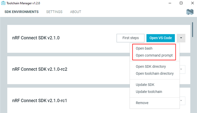

    Please share the complete build log.
    Can you try updating the SDK and see if this gives any errors? In the Toolchain Manager, click the down arrow and select "Open bash" or "Open command prompt".
    Make sure you are inside C:\ncs\v2.3.0, then run west update. Please upload the complete output from the command here.
