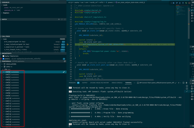

    I have set the breakpoint as mentioned, I see it is not coming to the break point. Do I need to call the API explicitly?
    For now, to put the device into sleep mode I am calling the below API.
    pm_state_force(0u, &(struct pm_state_info){PM_STATE_SOFT_OFF, 0, 0});
    No, you should not have to call the API directly. You do however need to let the program enter the idle thread. For instance, by calling k_sleep() after pm_state_force(0u, &(struct pm_state_info){PM_STATE_SOFT_OFF, 0, 0});

    Would you mind trying to debug the system_off sample to see if the breakpoint gets reached then?
  • Would you mind trying to debug the system_off sample to see if the breakpoint gets reached then?
    [AJ]--> We confirm it is coming to the breakpoint when we debug system_off sample.

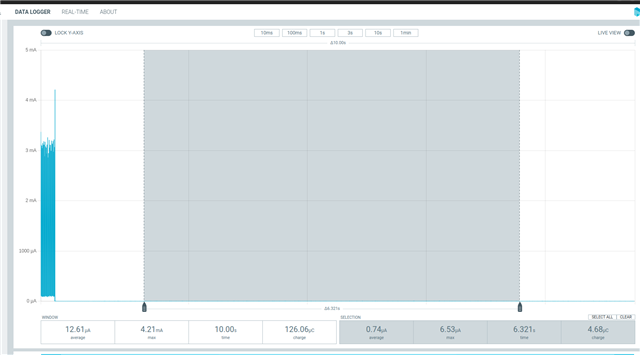

  • Is it the TF-M secure peripheral partition from SDK v2.3.0? I tried it here on a 5340 DK and I measure around 0.8uA in System OFF:
    Changes I made to force it to system OFF:

    +	pm_state_force(0u, &(struct pm_state_info){PM_STATE_SOFT_OFF, 0, 0});
