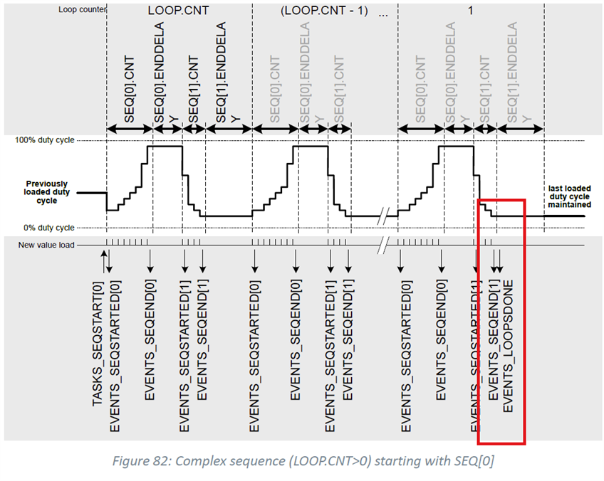

I'm looking for the best method to play endless complex sequences (seq0 -> seq1 -> seq0 -> seq1 -> ...)
Method 1:
Set LOOPSDONE_SEQSTART0 in SHORTS register which will trigger the task SEQSTART[0] when LOOPDONE event is raised. This seems to work fine but when I look at the datasheet of the nRF52833, I see that LOOPDONE event is raised one PWM clock cycle after last SEQEND[1] event is raise. The task SEQSTART[0] is triggered also one PWM clock cycle later. My understanding is that there is two PWM clock cycles playing the last loaded duty cycle before the new sequence starts. Am I right?
Method 2:
Set the LOOP register to its highest value (65535) and update it every now and then (before it gets to 0) with the highest value. I haven't tested this method yet so would this work?
Do you see any better method to do it?

  • This seems to work fine but when I look at the datasheet of the nRF52833, I see that LOOPDONE event is raised one PWM clock cycle after last SEQEND[1] event is raise.
    Can you point to where in the datasheet this is conveyed, I could not find it.
    I don't think this is true, can you point to where this is stated?

  • Here is the image that describes my statements
    Has you can see in this image, the LOOPDONE event is raised one PWM clock cycle after last SEQEND[1] event is raise.
    Hugo
  • I think the Prod Spec is a bit vague on the LOOPDONE --> SEQSTART shortcut timing, but I don't really understand why you think this figure describes how "the LOOPDONE event is raised one PWM clock cycle after last SEQEND[1] event is raised".
    Do you have a PWM scope of a LOOPDONE --> SEQSTART shortcut transition?
