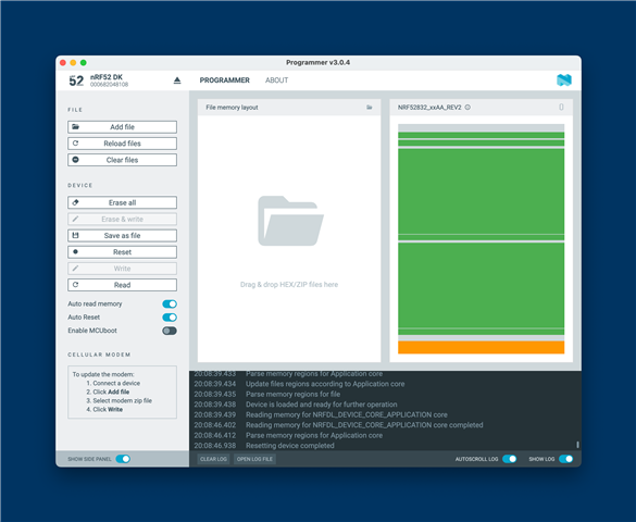

When I compile my app it looks like it's only taking ~68% of flash, and the message is saying I only need 4096 bytes more for it to work. But, I'm not sure how to change the partitions for this to work.
Memory region Used Size Region Size %age Used
FLASH: 33384 B 48 KB 67.92%
SRAM: 23744 B 64 KB 36.23%
IDT_LIST: 0 GB 2 KB 0.00%
How would I go about fixing this so I can update via DFU?
