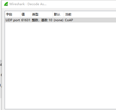

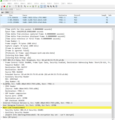

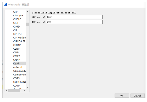

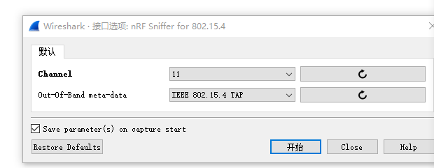

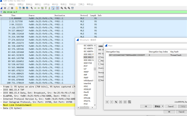

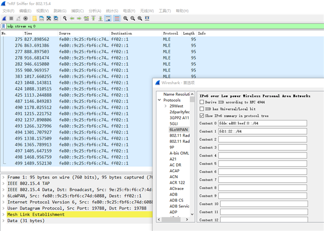

    If you could also do a sniffer trace, that could indicate what is not working. Ideally a sniffer trace when the issue occurs as well would be useful, but might not be easy to capture if the issue happens after a long time.
    If you can provide the device logs and sniffer logs to us, we might be able to help determine what is going on.

    Install the latest version of sniffer according to the link, but received very little data.
    Danny
  • Are you sure the sniffer is started on the correct channel? Looks like there is very few packets if your image shows the entire sniffer log.
    Can you try enabling DEBUG log level in your application build according to my previous links, to see if this provides more details in the device logs?
       The public version of the windowcovering sample I tested also has this phenomenon. Can you reproduce it?
       Following the process:Commission the sample,and Power off the sample for a while,and then turn on the power,the home app show no repond all the time.But The light_bulb  sample is working normally following the same process.
       WireShake configuration:(Use Nrf52840 Doggle),Are there any issues with the configuration?
