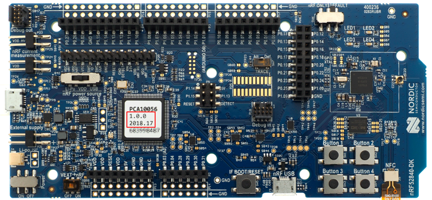

    Which version of the DK do you have? You can find the version on a sticker on the DK, as shown in the picture below:
    Are you using an external debugger, or only the DK?
