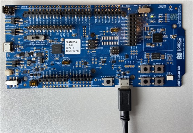

    I do not see the list of interfaces in the screenshot (as a menu covers it), but the rest of the information here all seems good. Which nRF DK/Dongle have you connected to the computer and are using as the sniffer (both type and version)? How have you connected it to the computer? And have you flashed it with the appropriate sniffer firmware (from the same zip as the other sniffer components)?
    I am using my nRF52840 DK Version 3.0.0 as the nRF DK that is running the nRF Sniffer Firmware that I flashed into it.

    This is all happening while I use the nRF USB on my nRF 52840DK Version 3.0.0.
    When instead of the nRF USB, I try to use the standard USB on my nRF52840 DK Version 3.0.0, I get the following messages:

    You need to use the nRF USB port on the bottom part of the DK as shown here:
    Using the USB port on the left side (with the debugger as a USB-USB bridge) will not work with the lastest DK revisions.

    I tried one more time to capture packets when using the nRF USB port, and this time it worked 100%.
    So the problem has been resolved.
