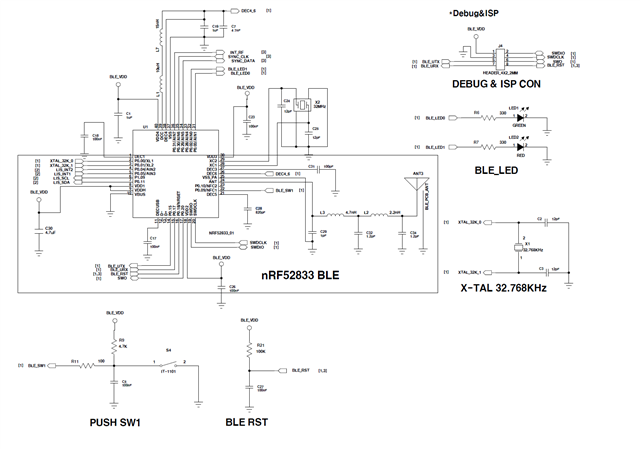

The left image shows the reference circuit of the nRF52833 DK board, and the right one shows the regulator circuit of our own developed board.
I added a DCDC regulator circuit to the DEC4 pin as a reference design like on the DK board.
When power is applied, the DEC4 pin is supplied with a voltage of 1.3V.

    Can you share the the whole schematics and the part number of the capacitors and the inductors that you use for the DC/DC?
    I can make the case private first if you prefer it..

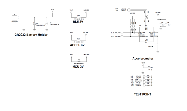

  • The circuit diagram you requested is as follows.
    I designed the DCDC regulator to be exactly the same as the nRF52833 Reference circuit.

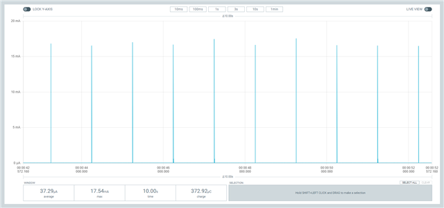

    After removing the capacitor from the main power supply, the current consumption of the ESB Tx was output as shown in the following figure.
    The power consumption appeared to be consistent to some extent. However, despite this, compared to the nRF52833 DK board, the power consumption of the ESB Tx appears to be more than twice as high.
    No LED turned on.
    The power consumption value indicated in the datasheet is 4.9mA.
    Actually, I think the power consumption of the nRF52833 DK board is also quite high.
    Can you tell me why there is a difference of more than twice the power consumption compared to the nRF52833 DK board?

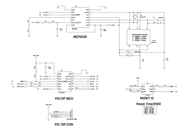

  • Hi.
    Is this the whole schematic, is there anything else on your custom board such as another IC etc?

    Exactly which capacitor did you remove, can you specify it in the schematic?
    Are you using nRF Connect SDK or nRF5SDK?
    Can you share the part number of the capacitors and the inductors that you use for the DC/DC?

  • Removed C28 and C6.
    can be translated to "This is the complete circuit diagram up to this point.
    C7 / 47nF : CL05F473Z05NNNB
    L1 / 1uH : MLF1608E100
    C19 and L7 are also products of the same subsidiary.

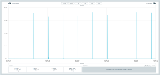

  • 1. Here is the power consumption waveform of the ESB Tx when not using the internal DC/DC.
    2. The serial is already disabled. It starts in sleep mode, and the power consumption at this time is less than 10uA.
    The power consumption of less than 10uA includes not only nRF52833 but also other CPUs.
    The power consumption returns to less than 10uA after the ESB Tx.
    Enabling the serial consumes 300-330uA.
    LED blinky consumes about 2mA of current.
    This power consumption is similar to that of the nRF52833 DK board.
    I don't know why the power consumption of the ESB Tx is so high.
    3. I am using PPK2 to measure the power consumption in Ampere mode.
    Can you zoom into the TX spikes and set the resolution to 100k samples per sec. PPK can show variating spikes when it switches measurement range if you plot is zoomed too far out.
