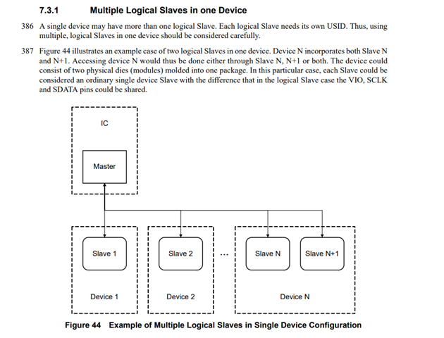

    Also, I'm not that experienced with RFFE but the spec seems to mention controlling two slaves:
    regards

    Can I just confirm that the request has been understood as follows?
    I'm not suggesting a full second bus, but just modifying the %XMIPIRFFEDEV command to implement that part of the RFFE spec that you have highlighted to allow two peripheral/slave devices.
    The %XMIPIRFFEDEV command takes an RFFE address as an argument which is likely being passed to the underlying RFFE driver. The feature request is to allow the %XMIPIRFFEDEV to take two addresses and sets of parameters, and call the underlying RFFE command twice.
