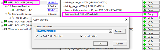

2. copied bsp_pca10028 from Pack Installer

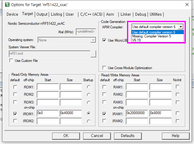

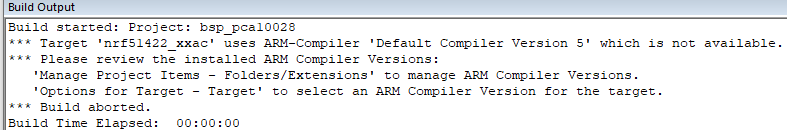

 - default compiler version 5 ???
 - changed compiler version

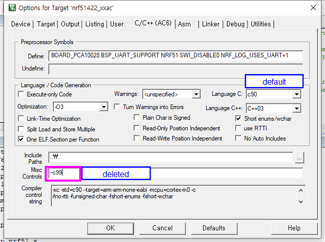

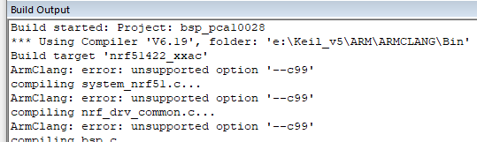

 - other problem, ArmClang: error: unsupported option '--99', changed option to default and deleted --99

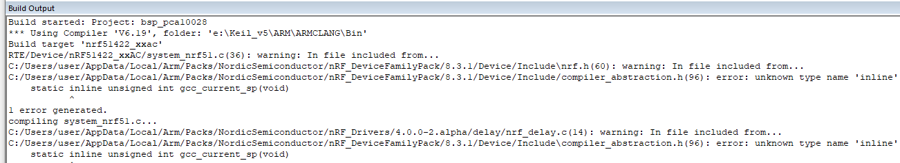

 - another problem, ???  ㅡㅡ;

    Yes, I've tried it and was able to download compiler v5 but I now realize that it's only available for people with a Pro license. What I suggest:
    1. You can contact keil support and ask them to send you the compiler version
    2. Keil free version has a size limit that means that you would at some point need to pay for the pro license if you're developing something close to a real application. Since you've just started, I would suggest that you either switch to using SES or switch to the newer nRF52 which is supported in the new and updated nRF Connect SDK.
