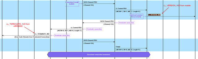

BLE_GAP_EVT_DISCONNECTED doesn't occur when connection is terminated after receiving LL_VERSION_IND
Hi
We established a connection with a mobie phone as central device and an nRF52832 or nRF52833 as peripheral device.
If we afterwards try to terminate the connection on the nRF with sd_ble_gap_disconnect(), the BLE_GAP_EVT_DISCONNECTED does not occur.
We have seen with a Bluetooth sniffer, that the SoftDevice sends the LL_TERMINATE_IND right after the central device has sent the LL_VERSION_IND.
Is it possible that the SoftDevice could not trigger BLE_GAP_EVT_DISCONNECTED because it is somehow stuck because it could not answer the LL_VERSION_IND?
If we add a small delay so that the connection is terminated after the SoftDevice answered the LL_VERSION_IND, the BLE_GAP_EVT_DISCONNECTED is triggered.
The problem occurred on the nRF52832 (S132 V7.2.0) and on the nRF52833 (S140 V7.2.0).
Do you know this behavior?
Many thanks in advance.
Remo
  • Hi Remo,
    This is a known bug. It is fixed in version 7.3.0.
  • Hi Einar
    Thank you for your answer.
    I just replaced the SoftDevice 7.2.0 with 7.3.0 (without making any changes on our FW), but the problem still occurs.
    Is it possible that this issue is not the same as DRGN-15619? Do you have an idea what else I can try?
    I have not been able to reproduce this on my end yet. I ended up with a slightly more modified ble_app_hrs example, testing on the nRF52 DK (nRF52832) and SDK 17.1.0, but with S132 7.3.0.The changes are mostly your modified main.c file, but I modified it slightly. For reference, the slightly modified main.c and sdk_config.h (where the change there is to use default data length and ATT MTU) are attached together with the sniffer trace: nrf_connect_iphone_trace.pcapng.

    Can you share a full sniffer trace showing all packets for a complete connection (starting and ending with the peripheral advertising)? Perhaps with that it will be easier to see which exact conditions need to be present in order to reproduce the issue.
  • Hi Einar
    No, I didn't mix up the disconnected reasons. I received 0x22 in the error case and 0x16 in the good case.
    We are using the Frontline Sodera BLE sniffer. Are you able to open these trace files? I made here a screenshot of the last packages of the trace from the Sodera:
    I looked into the sniffer trace you sent. When I see it correctly, there are two empty PDU's between the LL_VERSION_IND of the mobile and the LL_TERMINATE_IND of the nRF52832. Can you adjust the timing so that there are no empty PDU's between the mentioned LL packets? I think that this should reproduce the problem.
    Best regards
