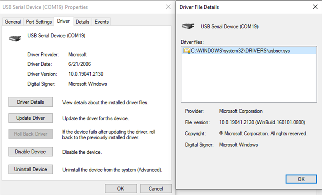

I am using nrf connect sdk 2.3.0 and have configured mcuboot for serial recovery triggered via pin so my users can update firmware via usb and a windows machine.
When powering on with the pin held low DFU mode is entered as expected.
However, in windows device manager a failed usb device "MCUBOOT" shows up with windows saying there are no drivers for this.
In addition a com port is also added, that appears to be fine.
When using nrfutil to list devices the trait mcuboot does not appear (device is E60EF9D290C74E49 and shows its serialPorts trait but no mcuboot)

Any attempt to program the device via nrfutil says programming not supported.

  • Hi Amanda,
    I already had nRF Connect for Desktop installed. But I updated it to the latest version just to check.
    Same result. I just don't think there is a usb dfu device class driver on the system.
    So then I followed the advice in this support thread https://devzone.nordicsemi.com/f/nordic-q-a/77824/usb-dfu-class
    and installed winusb.
    And now nrfutil can see the mcuboot trait
    E60EF9D290C74E49
    ports COM19
    traits mcuBoot, nordicUsb, serialPorts, usb
    and I just tried a firmware update and it worked!! I am guessing that if winusb is installed on the system already then this will work. But that is not a standard windows configuration.
    I do think that a note in the sample or the build script mentioning this for windows would save a lot of trouble.
