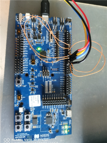

After connecting spim and spis' gpio,
After recompiling the code and burning it to 5340, you can see that the expected log is output:

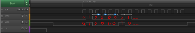

The normal SPI waveform can be seen by using the Logic analyzer:
##### Everything is normal here. #####

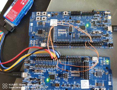

After burning the same code and connecting the SCK, MOSI, MISO, and CS cables,
I found a problem,
1. 5340#2 can output the log normally, indicating that the data for 5340#1 has been received:

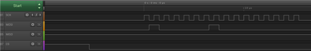

Looking at the waveform, it was found SCK,MOSI,CS is correct wave,but there is no MISO signal:
Make sure there is no problem with the physical wiring.
I have checked it many times but still cannot find the cause,
