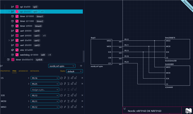

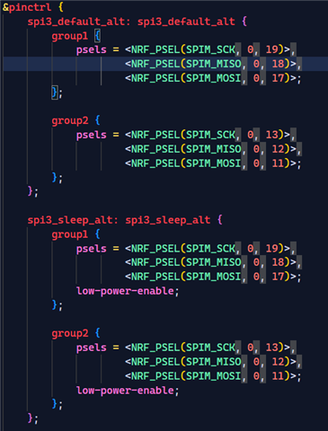

This is my overlay file pinctrl conf:

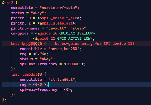

And for spi interface:
Ignore the 'no cs-gpios' is only on that screen but all works on build (I think its a vscode issue). I'm using ncs 2.2.0.
In the end I have this devicetree:
Now you see that I've pin on 13,12,11 for both bme and lsm. My question is if I've two groups why it keeps bringing the last one? Can I specify which group to use and how can I do it? I have to create another spi3 default and sleep for lsm (and every new device)? What is the scope of group if I cannot choose between them?
