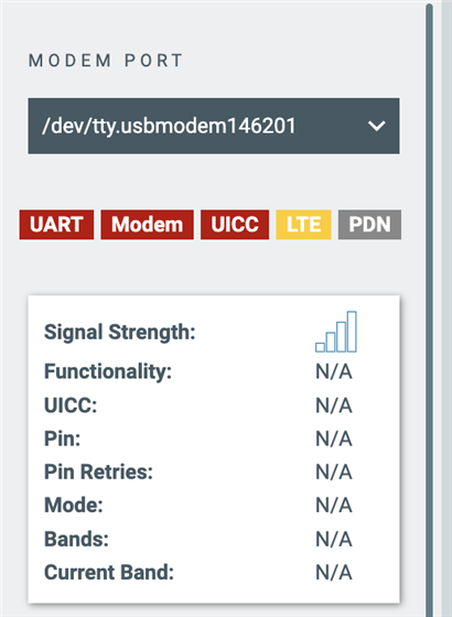

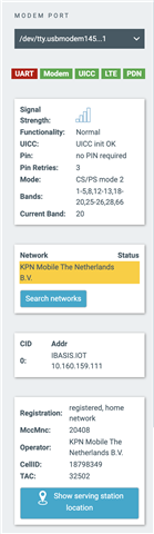

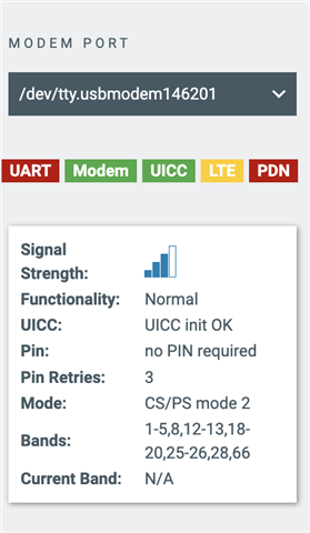

Poor reception Thingy 91
I am currently testing the reception of a Thingy 91 (hardware rev 1.5) in the Netherlands using the asset tracker v2 code.
It is running the stock code, but I have included the debug Kconfig in the build options to help with troubleshooting.
Upon initial power up, the device appears to connect to the network without issue. However, after allowing it to go back to sleep (where it only feeds the watchdog), I often encounter connection failures when attempting to reconnect by pressing the button.It seems to timeout/run out of retrys.
I am wondering if there are any network settings that can be adjusted to improve this behavior.
For context, the Thingy is situated in front of a window to allow better reception.
This is the log file from the LTE Link Monitor:

And this is the data from the side panel of the Monitor:

  • Thank you both for your advice!
    I updated my modem firmware to 1.3.4 and my SDK to 2.3.0 (I was using 2.2.0 first). But the problem still seems to persist.
