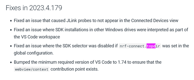

nRF Connect for VS Code : problem saving nrf sdk settings in version 2023.4.148
Since upgrading to version 2023.4.148, I am unable to select a local nrf-connect.topdir.
When I come back to version 2023.2.56, it works.
This is a bug in version 2023.4.148.

nRF Connect for VS Code 2023.4.148 (or 2023.4.179)
To reproduce:
- copy /opt/nordic/ncs/v2.1.3 to XXX/v2.1.3 (XXX being somewhere in your user folder)
- Open VSCode/nRF Connect :
- Open Welcome Page
- "nRF Connect SDK" => Browse
- select XXX/v2.1.3
- close Welcome Page
- open Welcome Page
- the nRF Connect SDK is back to "/opt/nordic/ncs/v2.1.3"
When checking the workspace settings file, one can notice that the nrf-connect.topdir is not set to XXX/v2.1.3 indeed, but to ${nrf-connect.sdk:2.1.3}.
