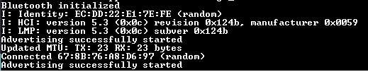

  • Please register the "att_mtu_updated" callback to get notified when the ATT MTU is increased.
    void mtu_updated(struct bt_conn *conn, uint16_t tx, uint16_t rx)
    	printk("Updated MTU: TX: %d RX: %d bytes\n", tx, rx);
    static struct bt_gatt_cb gatt_callbacks = {
    	.att_mtu_updated = mtu_updated
    void main(void)
       	err = bt_enable(NULL);
    	if (err) {
    		error();
    	/* Callback must be registered after bt_enable() */
    	bt_gatt_cb_register(&gatt_callbacks);
    Also, what service are you trying to write to, and do you get any errors when trying to write more than 20 bytes to it?
  • when 20 bytes are exceeded, no errors are displayed, only the data is not received.

    here you can see updated MTU, but still the same size.
  • The log shows that the ATT MTU did not get increased. Do you have another phone you can test with?
