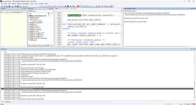

We require connectivity firmware for nRF52820.
For the prototype, we use the nrf52840 development kit and we are able to use the “connectivity_4.1.4_usb_for_s132_5.1.0” firmware.
We also try to compile the connectivity project from “nRF5_SDK_17.1.0_ddde560.zip\nRF5_SDK_17.1.0_ddde560\examples\connectivity\ble_connectivity" in that we selected "ble_connectivity_s140_usb_hci_pca10056”.
By updating the controller number from “nRF52840” to “nRF52820”, adding supporting files of nRF52820 and .icf files also follow the steps to Transfer the project to nRF52820 hardware as mentioned in the below link:
https://infocenter.nordicsemi.com/index.jsp?topic=%2Fsdk_nrf5_v17.1.0%2Fnrf52820_user_guide.html
But it is not working.
Please guide how to create connectivity firmware for nrf52820.
  • We were able to build connectivity firmware.
    We want to build it for nrf52820.
    As mentioned in 'Transferring the project to nRF52820 hardware file' we are not able to identify in which file we need to do the changes.
    Can you please give us the steps on how to build connectivity firmware for nrf52820.
