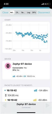

I use nRFConnect iOS APP to pair nRF52832 device. But it failed to show passkey dialog.

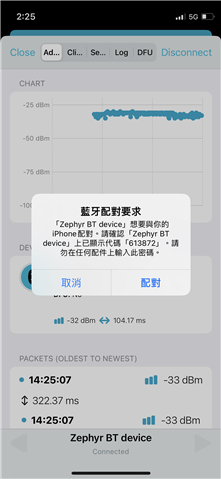

I have added the following configuration in prj.conf.
CONFIG_BT_FIXED_PASSKEY=y
CONFIG_BT_GATT_AUTO_SEC_REQ=y
CONFIG_BT_SMP=y
And I also add the following code in bt.c for static pairing
bt_passkey_set(123456); // in btInit()
bt_conn_set_security(conn, BT_SECURITY_L2); // in connected() callback function

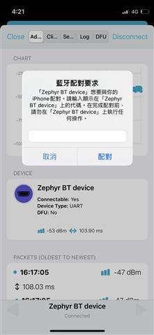

Now nRFConnect iOS APP shows pairing request information. But it doesn't shows dialog for me to enter passkey 123456.
I have another question. nRFConnect iOS APP shows connected even if I enter wrong passkey (e.g. 111111).
