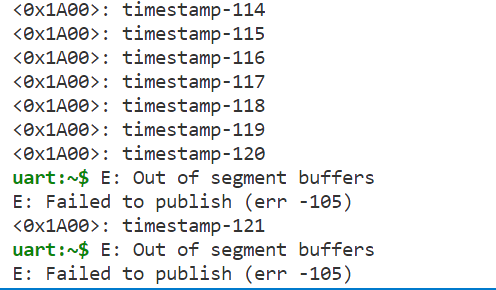

Hello, im trying to create a mesh system with sensors that work like a chat. I tested it on 5 devices and there is a strange behavior. After 120 test messages an error appears : "
i know it has to do with a buffer being full, but i dont know how to empty it. How do i get rid of this error ?
My code + config (the rest is mostly chat example) :

  • Hi Jejpi23,
    My sincerest apology for the long waiting time.
    As you have noted, the buffer is filled. However, it cannot be emptied at will by the application, as it is entirely controlled by the mesh stack. The rate data is "consumed" from this buffer is also controlled by the mesh stack. Therefore, our only approach to this is to reduce the rate the data is added to this buffer.
    Just like you have observed, one factor is how often messages are being sent.
    Another factor is that, how many times each segment is resent.
    As recommended by the Mesh Profile Spec v1.0.1 (applicable to nRF Connect SDK v2.1.2), section 3.5.3.3, each segment is sent multiple times. The number of times is configurable by CONFIG_BT_MESH_TX_SEG_RETRANS_COUNT. In my tests, reducing this to 2 has fixed the issue.
    On the other hand, I would like to recommend you reevaluate the strategy to send sensor data via human readable mesh chat messages. Like we have seen, segmented messages are quite costly to the mesh stack. It is actually quite costly to the network's throughput and the devices' power consumption as well.
    All of those are often scarce resources that needed saving.
    The Sensor Models are created for the purpose of communicating sensor readings. Perhaps you could give those a try instead?
